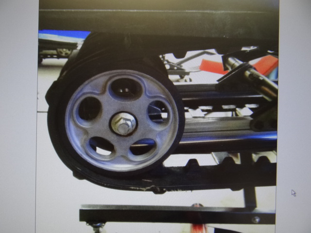

Re: Snosport Track Specs
The import company is named Sparrs import export AB
They have the tracks listed for $230 minimum order 100 units
I got one last winter and they work fine. I purchased it from a guy on Craigslist for $600
When I get a chance I will see if I have the contact info.
I will take a picture of the track on my Sport project
I see the Sno Sport tracks are listed on Ebay
I was very satisfied with the track works great.
Sno Sport aftermarket track
