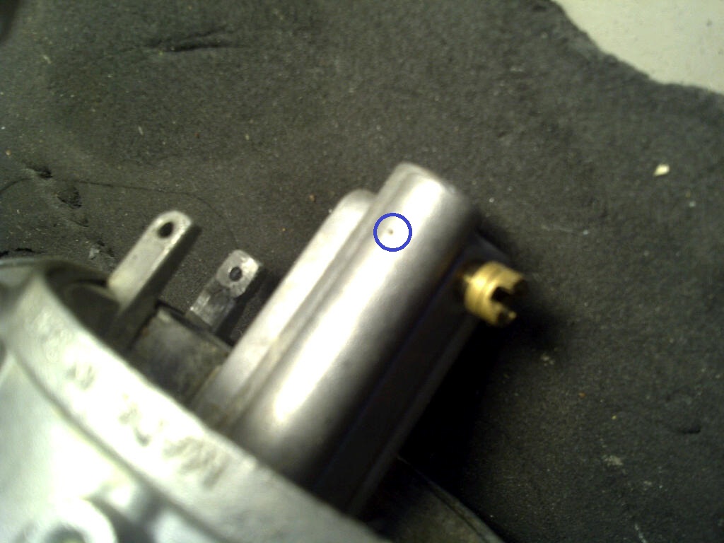

I have two Scoots and had the same issue with both of them. It would take sometimes 50 kicks and then run great all day. In both cases it came down to dirty carbs. I cleaned them dozens of times before the problem went away. One of my Scoots was in someones backyard for 10 years before I got it, so this one was particularly finicky. These carbs are so small they get clogged very easy. Many things can contaminate them: rotting air filter particles, old fuel left in carb (varnish), sediment in fuel tank, etc. Once you get the jets out and get the carb and fuel system real clean, you need to clean the tiny hole on the main stem that goes into the bowl. The hole is so small that my 45 year old eyes can barely see it. Typically, if it is hard to start, this little hole is clogged. I use a small piece of wire to clean it out.
Let me know how you make out.
Phil
image of carb and small hole that needs to be cleaned regularly
scoot carb.jpg (133.97 KiB) Viewed 12738 times

Thanks Fleabagz! I cleaned up the carb and reset the choke cable and it starts on the first kick now. Thanks alot friend!
