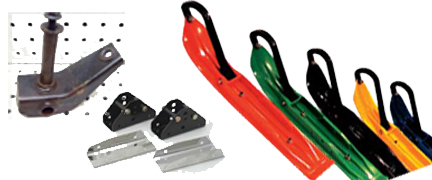

I have attached some photos of what I'm talking about.

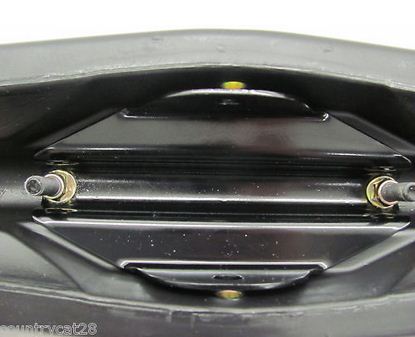

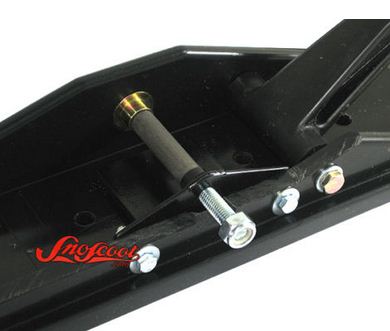

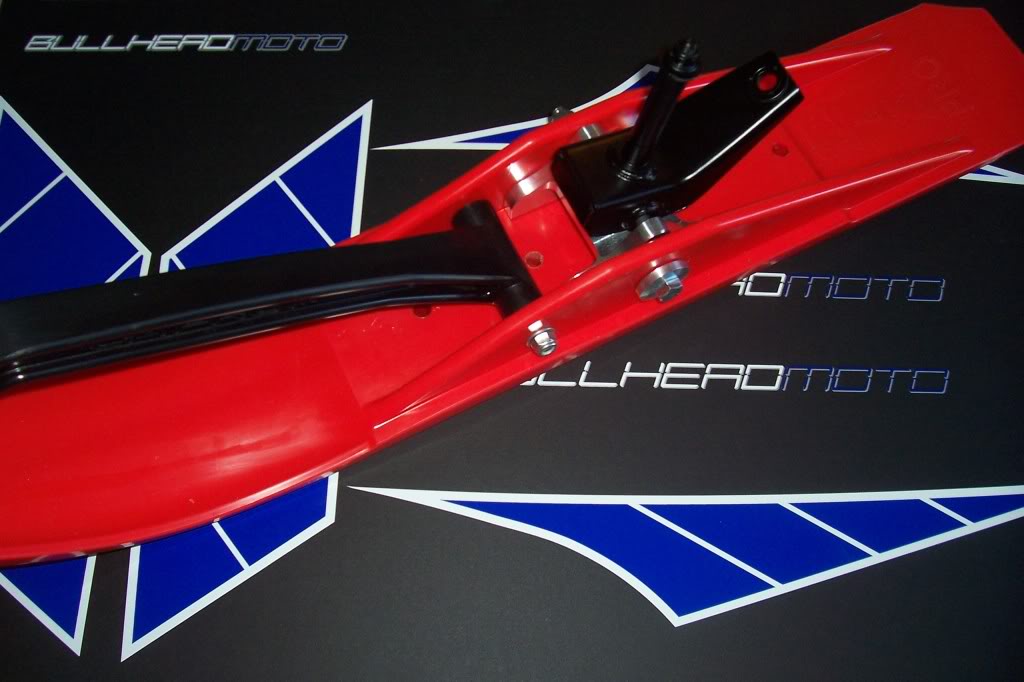

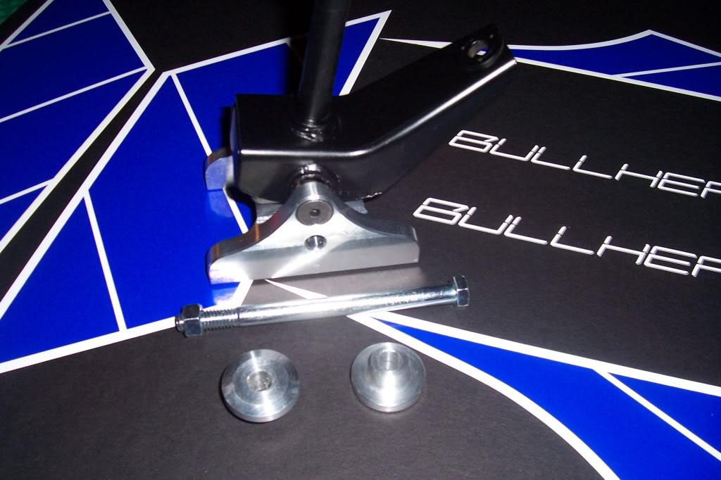

I am hoping to work out something like the arctic cat saddle, the bottom picture from snoscoot.com is an option I just dont really want to cut into the new C&A skis if I don't have too. Bullheadmoto had something but I am not sure you can buy them anymore, I would be interested in seeing how he was able to mount the skis.

The reason why the C&A skis need to be cut, is due to how high the plastic sits above the mount hole. This area will hit the ski bump stops when the ski pivots up and down going over uneven terrain. I am going to try to make my saddles higher so the spindle mounting hole is above the ski, so I don't have to hack my new skis up to make them fit.
BTW, Bullhead Moto left a lot of people very upset. He collected money for parts and pre-orders and than stopped responding. My buddy was one of those guys that got screwed.
His ski mounts were pretty sweet - Machined from billet aluminum.

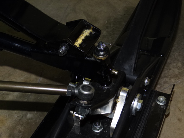

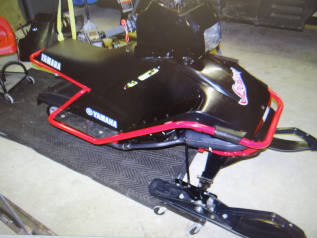

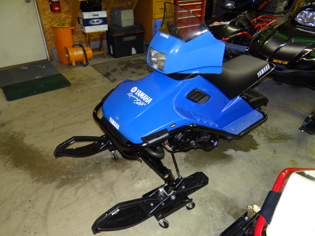

The C&A skis work great. This is how mine turned out.
I had the mounts machined by a guy in Wisconsin.

I have added some better pictures. PM me and i will get you the information. These mounts are like the ones BHM was selling.
I had four sets made and the guy told me he would do it cheaper if i order 25 sets.

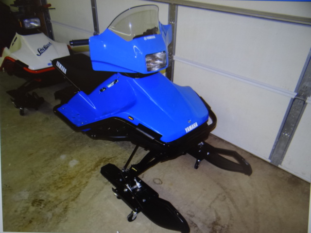

Nice fairing around the light. What is that off of.

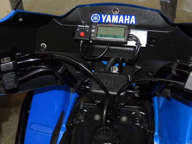

The fairing is from a 1990 Yamaha Phazer with a short windshield. I had it custom painted to match the blue shroud. It will mount directly to the Sno Scoot steering post. This is a very easy mod.
I also added heated grips and a display gauge that shows RPM, cylinder temp, Batt.voltage and clock.

Just got the mounts, they look awesome! Great job BB500!
Thanks!
I hope to install them this weekend and will definitely post some picture.

Hey BB500, sorry I didn't post this sooner. Got a little side tracked with our new baby.
I got the mounts on just before the snow left last year. They are awesome!
Much better then the stock skis and handle great! Thanks Again!
