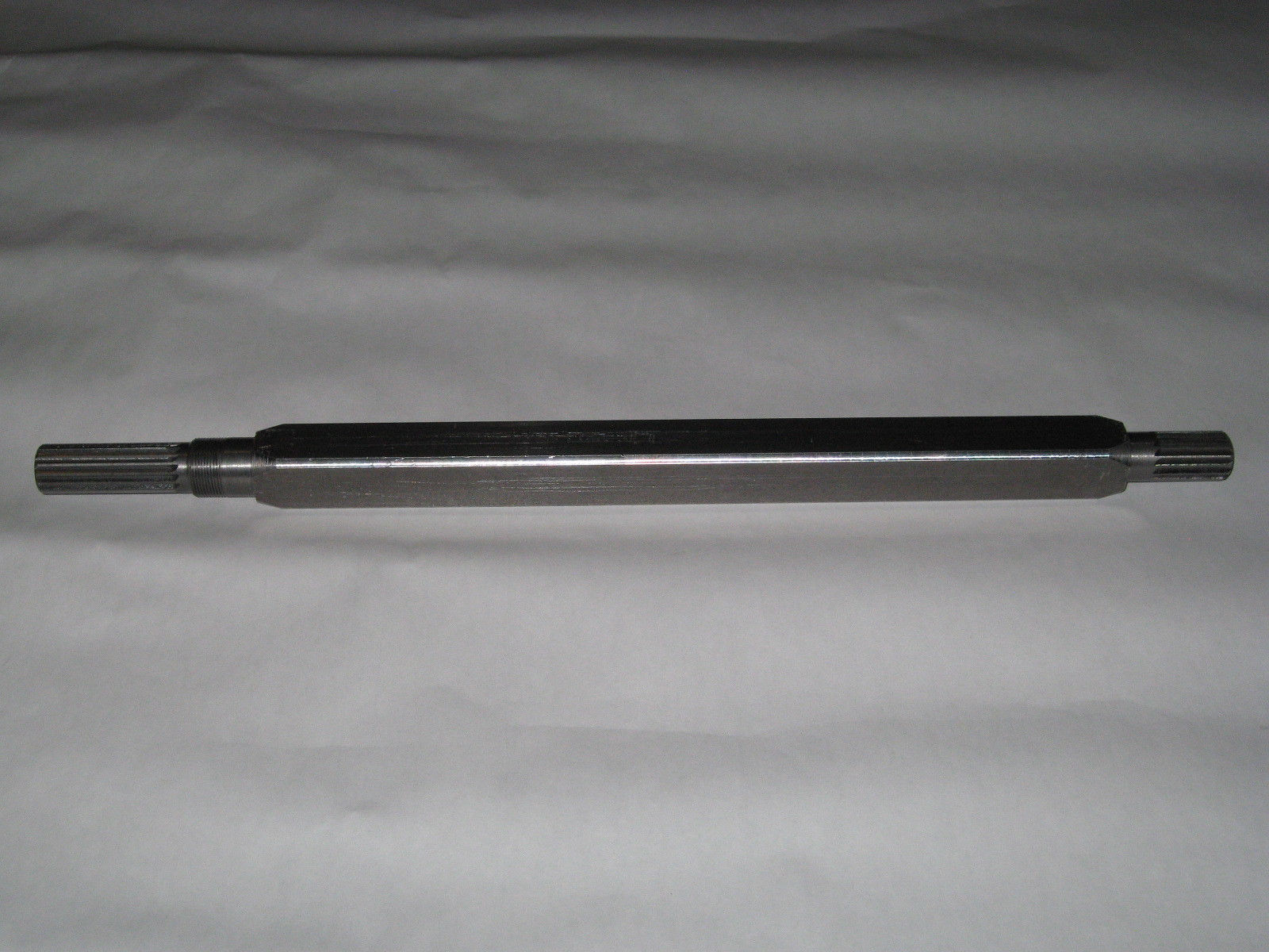

I now have available (via my brother who is a mechanical engineer as well as a licensed tool and die maker AND a licensed machinist)brand new freshly machined SnoScoot axle/driveshafts. This is a direct replacement for OEM Yamaha part # 85G-47511-00-00.
This axle will fit all model years 1988-1990. This came out of a request I made to him when the splines stripped on the axle of my son's scoot which most of your are familiar with on here. He reverse engineered the original axle and produced one for me. As he became aware this was a common problem on scoots he made a limited production run of 10. Many of you have likely seen the hydraulic disc brake mod bracket he has made and sells as well for the scoot

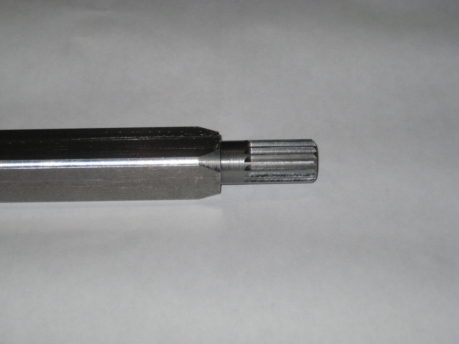

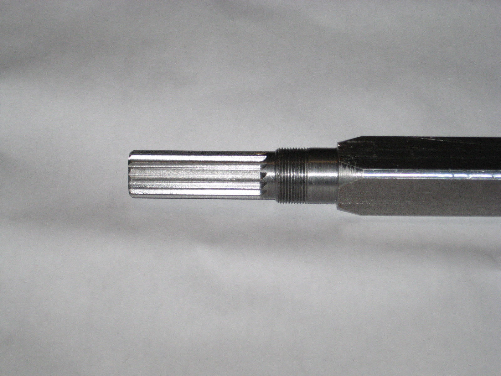

This axle is designed to transfer all of the original components from your worn out axle onto this one provided they are in good working order. This axle is machined from 1045 CRS medium carbon steel which is equivalent to the original and treated with a corrosion resistant polymer based coating. The drive splines are precision cut on a 4-axis CNC vertical machining center. Every axle is machined to tight tolerance and tested for spline fitment, bearing fitment and thread accuracy to ensure high quality standards. The square shaft machined tolerances allow for the plastic drive cogs to be reused as well by allowing a tight press fit onto the new axle. 100% fully tested on a SnoScoot.
The original axles were prone to failure due to a condition known as ‘corrosion fretting’ which occurred between the transmission drive gear and the axle splines. The corrosion grit and dust continued to grind away at the splines. This occurred due to the fact that grease was not applied before fitment during the factory manufacturing process. This condition gradually gets worse until the splines start to slip and become completely stripped preventing the track from turning altogether.
These axles are obsolete from Yamaha and there are no known aftermarket replacements until now.
